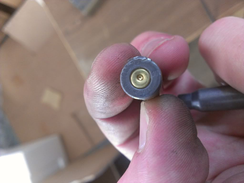

so i have put about 100 rounds of steel ( i got 200 ish for FREE) and went to this new indoor range in my home town today and decided to finish off these steel POS rounds bc they were free and i didnt have a problem the first time....MISTAKE ....after about 20 rounds i started having them fail to eject ... sweet ... BANG .....drop mag, clear double feed, recycle & eject spent cartridge. after about the 3rd i really got one stuck...so bad that i had to field strip my AR take my cleaning kit out and eject the cartridge sweet ....
so i know steel on AR's suck for many reasons the coating gets hot and little bits of it end up staying in the chamber and after some time and build up it acts as casing glue ....this is not good...not to mention most steel case ammo is made in russia ....... (in a russian accent) "mother russia we make lots of bullets so we save on quality control"
so here are some pics of where my extractor raped the steel case and did NOT eject
after this ordeal i will never EVER put a steel case anything down my AR brass is $2 more for 20....totally worth the money

Is that Tulammo? If so i think that is your problem. Compare the primer of the one that got stuck to another that didn't and i bet it is pushed out further than the one that didn't. As with the other thread with the case ripping i think that the tulammo just has poor Q.C. and you got a "hot round". I have fired 2000+ Herters steel ammo out of my AR with NOT ONE issue! But with the tulammo i have had a lot!

It sounds more likely that you have a tightly cut chamber. Steel causes malfunctions in extraction because it does not expand on firing like brass does. This allows all the crud from firing to build up between the case and the chamber. That buildup will grab a case in the chamber quite solidly if you have a tight chamber, this is where the myth that steel is dirtier comes from, more blow by.
An example of this is what you are experiencing. My rifle is cut for true 5.56 NATO spec, not the usual .223 Wylde that most are and so will shoot the steel stuff all day, even with my suppressor attached without issues.

Problem solved!
1st picture says it all in about .4 seconds
Notice that dragy scrapy "key on the paint" look down the side of the shell, and that shiny little ding right above the rim?
BURR or left over bullet coating that's stuck in the chamber...time to rub a dub dub scrub it clean (ever heard of sticky bolt syndrome on the Russian Man cannon...well same thing..but on an AR that FORCEABLY snatches the round out with gas pressure... what do you expect to give...the extractor, or that soft maleable metal of the cartridge
Your AR is doing what it is supposed to be doing...YOU ain't! Clean the chamber shiny smooth!
Believe it or not...a teeny bit of gun oil on the fingers when you load your mags also helps [kinda like resizing oil], keeps em slicky smooth

Problem solved!

So then the DD should have a full auto carrier... My thoughts of what is going on is that the rifle is being over gassed (gas hole could have been drilled a lil' big?) when running steel, thus the timing is off an its running a bit fast. The over gassing is what is causing the extractor marks, because what happens is the gun is trying to extract the case before it's contracted from the chamber enough to be extracted without excessive force, thus you have the marks on the cases (and remember steel steel expands/ cools slower so it's exaggerated)
If your rifle experiences similar results with brass in the case head, your rifle is definitely over gassed. But if it's fine i'd just say don't shoot steel. and stick to brass.
